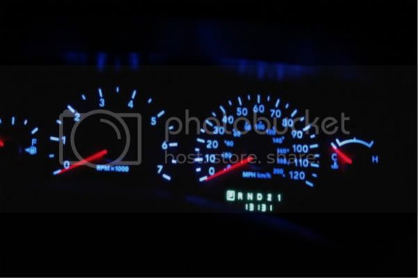

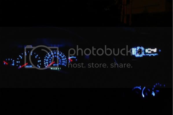

you can do white or blue. i did blue and the pics do it no justice. it is ****** awesome at night. if you guys are doing this feel free to ask questions to me awedaniel or nim81. george has done this as well. im working on the write up but would like for it to be complete.

Almost dark here, can't wait to snap the after picture :rockit: ! Didn't do a before because I'm pretty d*** sure anyone wanting to do this already knows what the stock lighting looks like :yucky:

Just a heads up, the pictures do it NO JUSTICE what so ever. That and I found a better setting on the camera after I took these so they could be better but still no justice. Just add a few shades of deeper blue (Could have edited them on PhotoBucket but didn't, will next time).

nice pic kyle. they still dont look as good as in person
