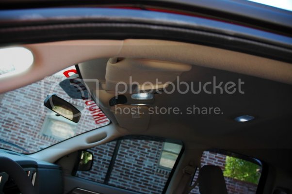

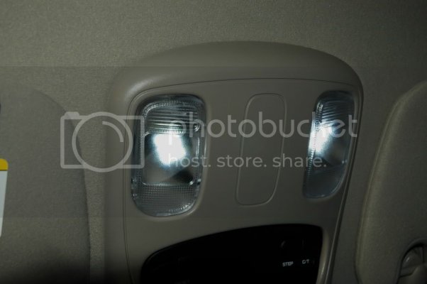

I wish I would have made a diy with mine its so easy though. Just buy the bulbs pop off the covers and put the new bulbs in. Here are pics of mine. get my lights at autolumination.com
