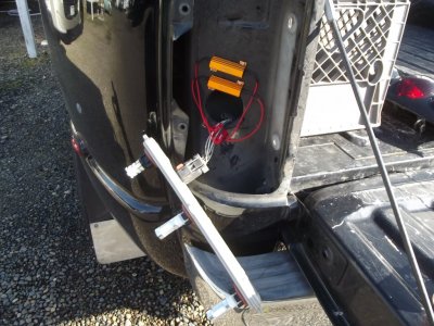

I tried regular LED 3157 bulbs and had the same problem. I installed the resistors and mounted them to the metal behind the housing with enough wire lead that they don't interfere with pulling the lamp housing. Now I understand that they do make 'CANBUS' bulbs that are wired internally to work with our TPM and skip the "Lamp Out" warning, but I'm not sure if they prevent the hyperflash or not. The CAN
BUS can be installed either way (not ground specific) I do know that because I have a bunch in my RV. It can be a pain installing the resistors, but they do work. I have blacked out housings and need the LED for the brightness. In the stock housings they are really cool. Good luck.

I'm having good luck with my led upgrade. I put 24 SMD bulbs in the backup lights and they put the incandescent bulbs all to shame. I got some super bright ones for the brake and turn because of the smoked housings. No hassles with the lights or the cops. :happy160:

Thank you for that picture @Smokeybear01 !!! I will probably do that after a couple of my incandescent bulbs burn out.
