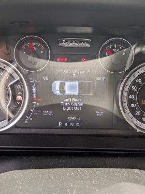

So I upgraded all my Halogen bulbs on my '18 to LEDs the last two days. The Low Beam, High Beam, Front Turn Signals, Fog Lights, 3rd Brake Light and 3rd Brake Light Reverse lights, Taillight Reverse Lights, and Taillights. Everything up front works with no issues or errors. Everything in the rear works as well...but when I start her up I get an error for Left Turn Signal that then makes the driverside mirror turn signal andhand indicator on the dash(the front and rear work at the expected rate). It also tells me my right brake light is out (I checked, it works fine). Furthermore it says my backup lights are out (put the parking brake on and threw it in reverse and ran around to see no issues).
Any thoughts on how to clear this up? I've flipped the bulbs in the rear to no avail.

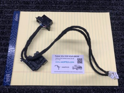

AlfaOBD and the OBDLink MX, and the bypass security harness for the 2018's sold by M2Mods. Once you get those, then you can go into the BCM and change the exterior lights to LED present in the setting menus.

No. In later vehicles FCA added a firewall that prevents tools like Alpha from making changes via the OBD port. The harness bypasses that firewall. You will not need the 4 digit RF hub PIN for this change.

Bypass harness- got mine from kaodtech

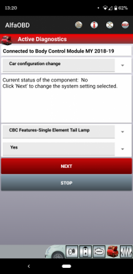

Alright so I went through and updated the Tail Lamps, Reverse Lamps, Rear Stop Lamps and Rear Turn Signal Lamps to LED via AlphaOBD with the OBDLink MX and am still getting a message for left rear turn signal being out.
I'm wondering what it could be at this point and how to troubleshoot. There is also an option to changes the rear lamps to single element but I'm not sure that would do anything. Or could it simply be to flip the light?
Thanks in advance.

Another quick update: set the tail lamps back to halogen and when I unlock the vehicle the left rear taillight goes out while the right stays on. When I set it to MAR to see the error, it says the left rear turn signal is out.
I am now tho king there may be a short somewhere.
On another note, when I drove it this weekend on the highway it intermittently would work fine (with the LEDs) then if I hit a bump the error message would pop up. Thoughts?
