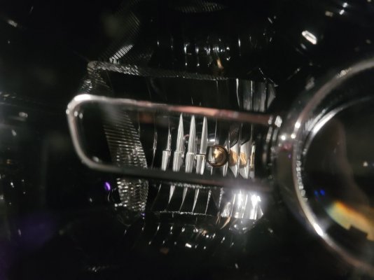

Figured id update my lumibright leds ive had in my projectors for about 27 months since im seeing so many led/hid headlight threads.
Well they are sucking now lol going south in the last couple of months, drivers side has lost a chip and both just dont light up the road like they did new.
Im now thinking about 55w innovited hid's, cheap and 2 year warranty.

Dang, you’re only getting about 2 years out of a $160-a-pair LED’s? That’s terrible. How often have you drove at night in that 2 years?
I’m surprised those LED 9005’s I bought from SparkSmith came with a five year warranty.
Do those lumibrights have electric cooling fans on them?

I have a work van so my truck sits most of the time and only goes to homedepot, food shopping and the gym! So any night driving is mostly to the gym. I do not have them set as daytime running either.
They do have cooling fans. Yup turned into a waste of cash.
I would really like to find a cheap set of factory black projectors and open them up to add the true hid projectors and switchbacks.
I keep following all these threads to see how these alpharex and others make out also, hate to penny up on those and they die in 2 years.
Which leds did you buy?

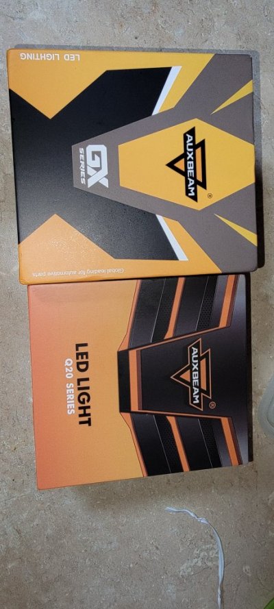

I have been using auxbeam with no issues. I have the gx for the high beams and the q20 for low beams.
