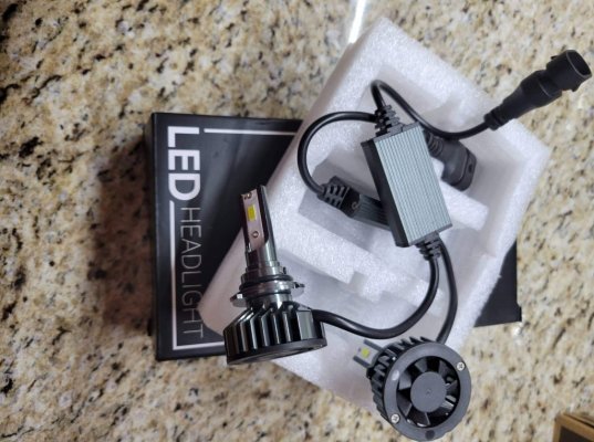

I've done tons of research in the past and in general, HIDs will out performance LEDs in a halogen housing. That's because of chip placement and the thickness of the stem on the bulb, the focus of the light is not in the same spot as a halogen or HID bulb but off to each side. But because of the ballast box and other pieces, it's a PITA to install in a lot of newer vehicles. I've tried so many different LEDs and been disappointed each time but aftermarket HID kits do not seem to last, I was always replacing a ballast or a bulb it seemed. So I kept trying LEDs, determined to find a good set that were designed properly.
I tried these in my '14 Ford Fusion Titanium in it's factory halogen projectors and was blown away at the performance so I ordered them for the Ram as well. They got the chip placement perfect, the output and cutoff is very nice and I have yet to be blinded. I have them in both the low and high beam positions on both the Fusion and the Ram, the highs on both are regular reflector style halogen housings and these LEDs perform amazingly well.
I'd HIGHLY recommend these. They fit in the housings nicely without the need to cut as well.
I'll have to get some night time output pictures but here's the pattern of the lows

I may have to consider those someday, but you do have those clocked at nine and 3 o’clock correct, in your lowbeam projectors?

Nope, they're at 12 and 6. Do these projectors like 9 and 3 better? Haven't tried them there yet

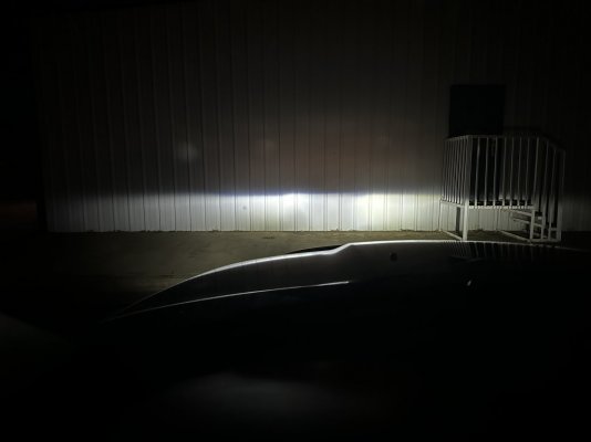

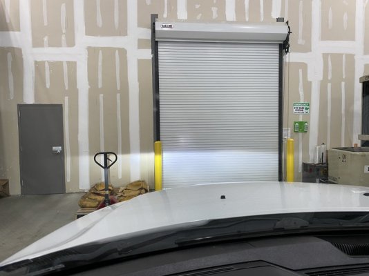

Well guys, I pulled the trigger on a set of LED’s for my lowbeam projectors. Bought them from Tri County LED that was recommended to me from one of my Facebook groups. They’re made by SyneticUSA and are a CSP type LED which is what I was told you want for projectors. They’re 6000K color and supposedly 6000 lumen in brightness but overall, they’re not bad. The pictures make them look a little bit brighter than what they actually are but I guess if there was any complaints about them is how they make my projectors look like snake eyes… Lol.
I have them set to where the blades are straight up and down and the LED chips are at three and nine on the clock face and really the only dead spots they have is like right in front of the truck which is not really that noticeable and if they are, I can just turn my fog lights on and then they disappear.

That's interesting. I have the same ones in my projectors and they are great. I changed my fogs over to LED, too.
I made the changes the settings in the BCD to use LED's for the heads and the fogs and I have no problems with them.

I didn’t have to change anything in my BCM because these have little modules in the wiring that makes them canbus friendly.
But did you clock yours the same way at 3 and 9?

Yes, I clocked at 3 and 9. Put a dab of silicone to hold them there.
Even though the LED's have the modules, I also made the changes. CANbus friendly is one thing, but the BCM also looks at current draw to determine if you have a failed light. Hence the LED, HID and xenon settings for them.
