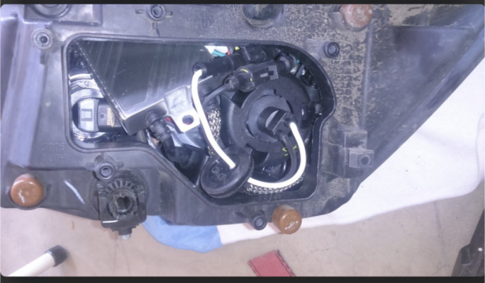

I really don’t see how any baggage from a HID bulb would fit in these OE premium headlights. Maybe I’m wrong. The ones I used had two black boxes that one of them was about half the thickness of a pack of cigarettes.

Pic @Jrod posted some years ago in a thread, ddm tunning ballast.

Wow that was ages ago. Those HID’s didn’t last long at all.. I scrapped HID and LED till a few weeks ago. I went with Underground Lighting 35w 6000k and they’ve been working flawlessly. I did have to reverse polarity to them ignited. And I had to add the rubber grommet from my halogens to make them snug. I also purchased this dust cover to clean things up after drilling my old ones years ago.

Yeah them ddm's use to be good but not so much anymore, i didnt like mine.
