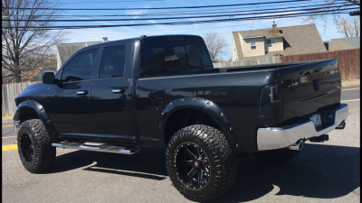

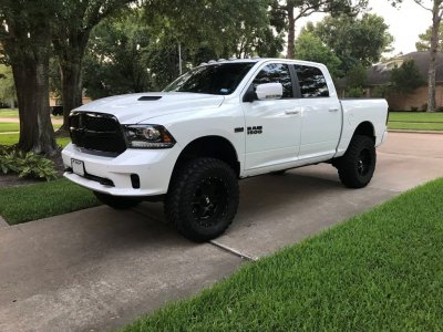

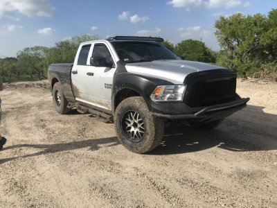

Looking for similar look to this.
I am new to the forum. I've lifted multiple trucks in years past but need some insight. Jb1 recommended I follow this thread. I have a 2017 4wd Ram 1500 5.7l, looking to run at least 37 or 38's on 22x12 wheels preferably. I was recommended to run the 6" lift with bilsteins cranked up to get the 8" I want. I have no problem adding a body lift as well. But truly would like around 10" of lift to run 38's. Any other suggestions? Wheel offset recommendations? Thank you everyone in advance.

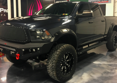

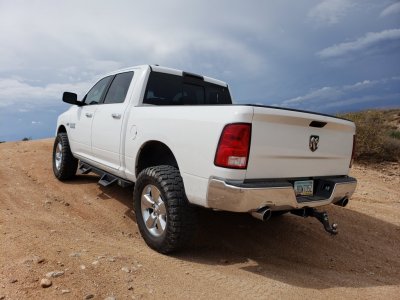

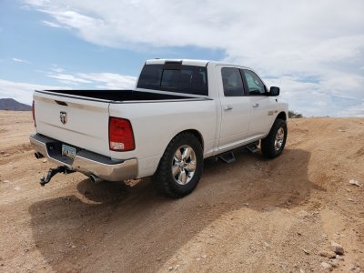

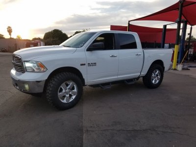

2015 2wd
4"/1.75" CST lift
Factory Big Horn wheels, No Wheel Spacers
37x12.50x20

I do need to get a tuner to adjusted my speedometer at 65mph I am 10mph's off +/- so I have to watch my speed

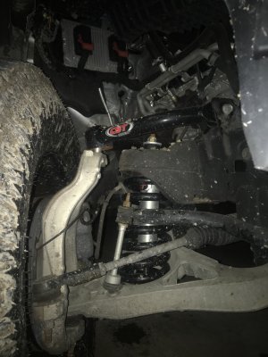

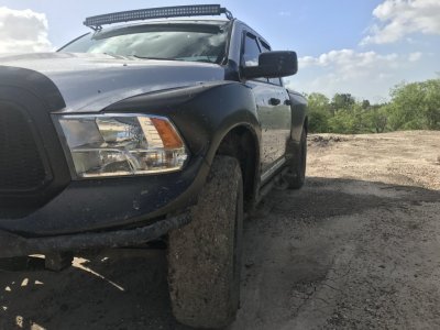

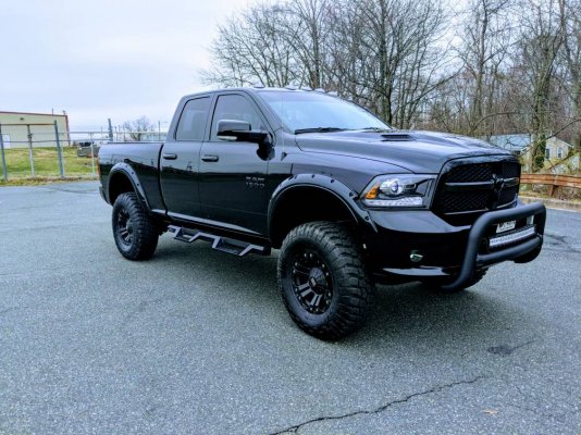

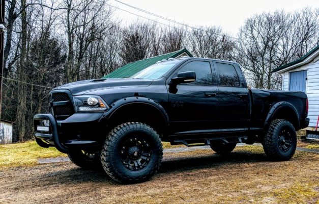

I actually forgot this thread which is surprising considering the amount of time I spent reading and looking over it before I got my 37s.
37x12.5 BFG KM2 MTs
18x9 XDs -12 offset 4.53 backspace
Zone 6/5 w Bils at 2.8"

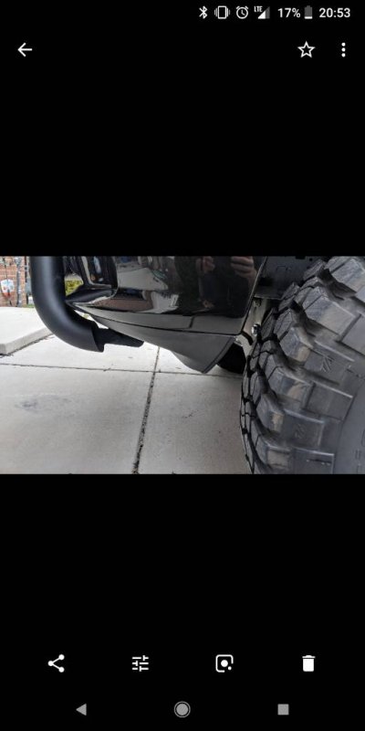

Slight rub in reverse on lower air dam, need just a little bit trimmed off

Your truck looks great and yes it’s a good thread for people to reference if they are thinking about getting 37’s

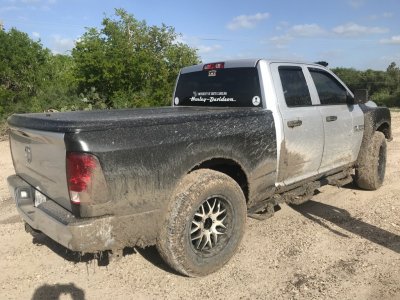

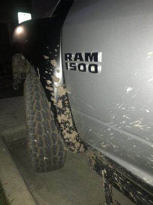

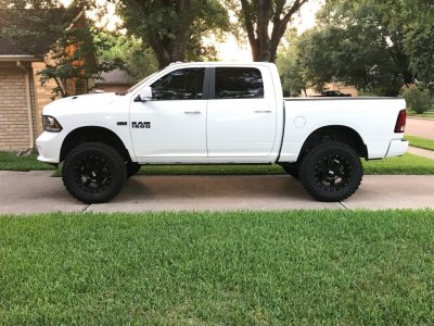

20x12 with 37x12.5 nitto ridge grapplers
