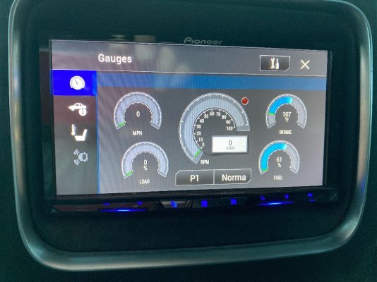

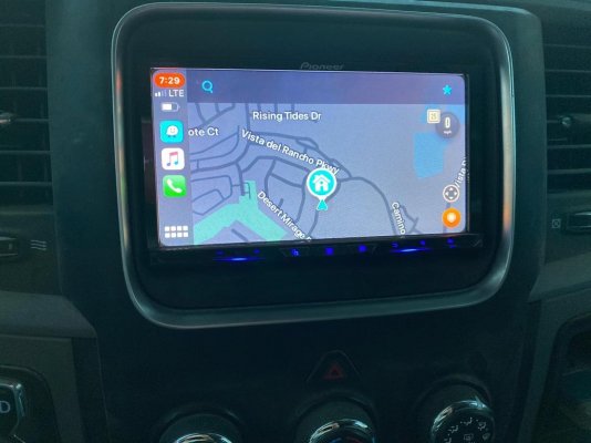

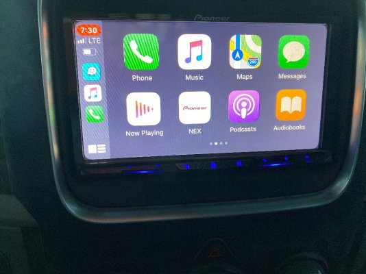

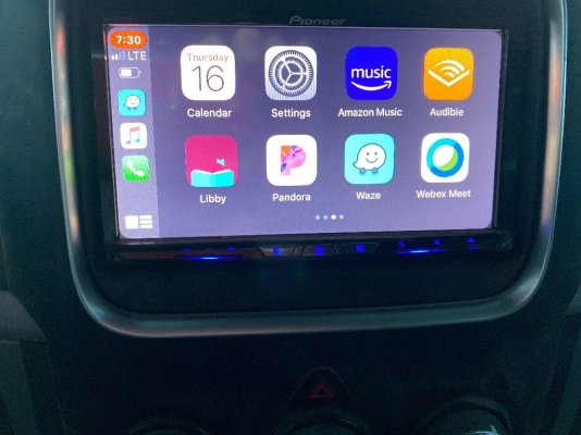

I’ve got a 2014 1500 Tradesman with a pioneer 4500NEX installed in it. It’s got wires and wireless CarPlay and android auto. It loos good and runs circles around the oem units 5189e61ac0abbedb260681bbaab1ae03.jpg

Looks nice. I tried buying a UAS through here but got shafted. Next is doing what you did to my 18 Tradesman.

I bought it through crutchfields. I paid them an extra $25 to make up the harness, well worth it. It made it a half hour install. It was easy to do and I only wish I had done it sooner.

Pioneer avh4300nex here. Even though I could never get it to display vehicle information like the speedo or tire pressure like Michael. Still couldn’t be any happier.

Wheel controls work?? I was looking at adding this model and a backup camera too.

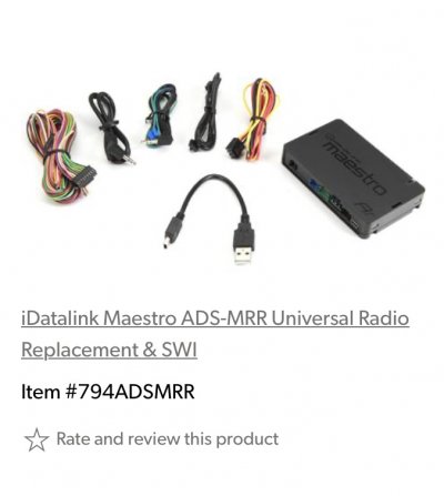

The wheel controls work and so does my oem backup camera. Just gotta get the idata modules so all oem controls work.

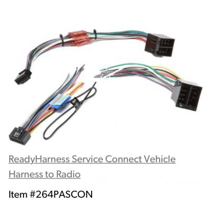

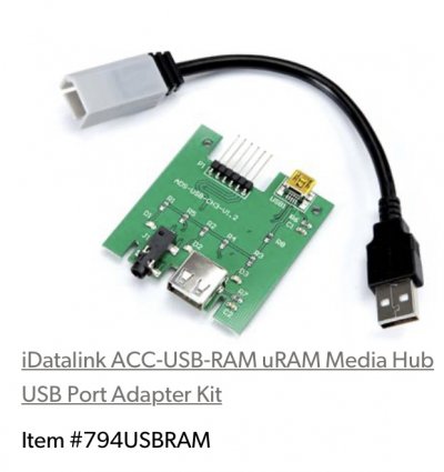

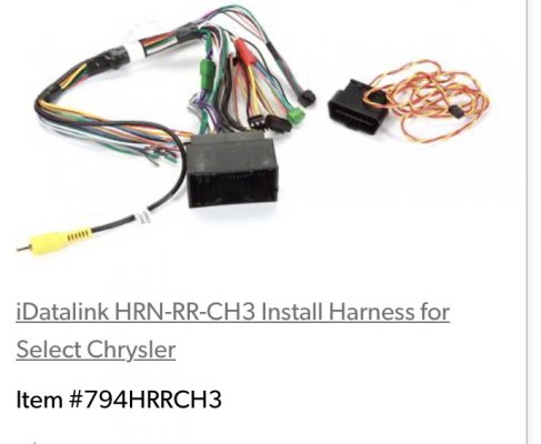

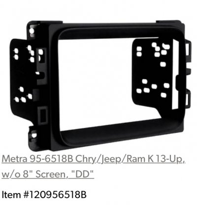

What all do I need to buy for this set up
The radio you want, then the following.
7hYi6zvmCST5sRRK6Woov3.jpg 2qcqpyu4LR6HzLsf3KdQiY.jpg 5DJAViO7B9OUhpH1GBPaZf.jpg htK6Tl4yMno9GHPktAZVD.jpg 58cIBsdPeE7ecBCdXNaHNt.jpg 3qzB49gnhjkADr6uRZdyo1.jpgI bought my radio plus all the stuff listed from crutchfields. I also paid them an extra $25 to make up a harness so I didn’t have to. With them doing the harness for me, it was all plug and play.

I need all this plus the aftermarket radio right?

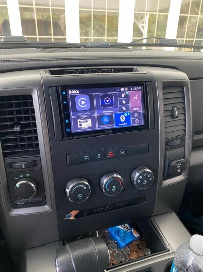

I put a new head unit in my 2010. Has CarPlay and backup camera hookup. Planning on getting the tailgate camera soon. Goes nicely with the two 12s under the backseat lol. 6da1df4c42c64ae77bef9b522aa2bf20.jpg
I don’t have the picture anymore but this is what I have in mine currently.

It’s the boss audio bvcp9685a. It’s not anything crazy good but it’s better than the stock unit. I looked at a few alpine units and came really close to getting the Pioneer 1400nex but this Boss was a good deal and it paired up well with steering wheels controls using a PAC interface

Can you send the link for this. I have a 2011 ram Laramie would like to update with this radio.
