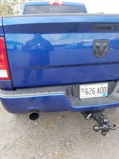

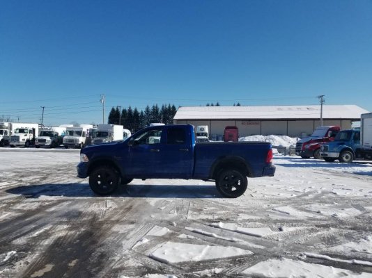

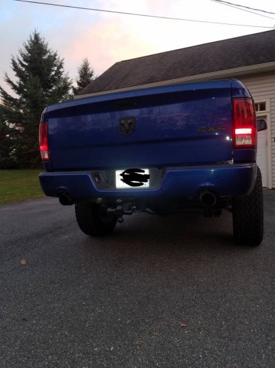

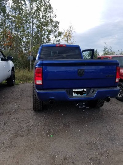

For those running the 1.25 and 1.5 body lift. Can I see a photo of the back of your truck? How does the exhaust tips look
View attachment 121017 This is Bilsteins at 2.1, 3/4" rear spacer and zone 1.5" BL. I also have a PA 3" BL in the garage that will most likely replace the Zone 1.5" BL eventually.
I know I've seen pics of the receiver on a lifted truck. I'll see if I can find it
