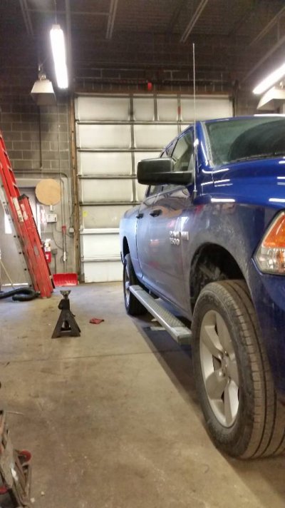

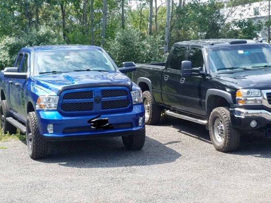

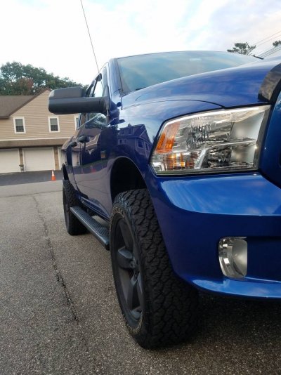

Zone 1.5 body lift and 2.5 front level with 1.5 rear spacer,
First picture is level kit only with factory tires8191a9a4641a6c40c52dba25d3dd4279.jpgbbcef4505d15a2ccb2260599433630e2.jpg88f61805da7e2deb84b9e9469b734e0e.jpgf110903d37c071d1b53b1749d2d4cec0.jpg

Pearson, can we get a nice side shot of the truck?
