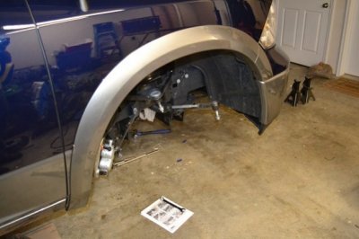

So my RCX 6" showed up yesterday. Started after work got the front end torn apart yesterday. Came home early today dropped the diff out did all that good stuff. After about 30 mins of swearing at who ever designed the strut spacer and a trip to Lowes front end is done. Went to put the wheel spacers on since I still waiting on my tires......they don't fit awesome, so she is stuck until tomorrow.

Keep use update.
If I can give you any advice..... check the nuts that are welded on the RCX cross members. The nuts you are going to attach the skid plate to. Make sure you can thread a bolt through them. Me, and some other members, have played hell with this part of the lift and tapping the threads was required.
I put my 6" RCX on a few weeks ago so everything is still fresh in my mind. Hit me up if you need some help. I'm usually up and moving around after lunch.
