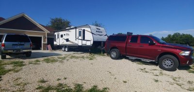

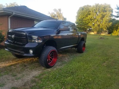

Stay as light as you can on your tt mine is 5807 dry which is useless most dont travel dry. Add propane clothes and other randoms closer to 7500lbs. I have a 18 crew cab 4x4 with 3.21s with a 6" lift and heavy 24x14 and 35x12.5s. I definitely feel the difference but still now issues. A good wdh is a must. I'm going to get a bulletproof drop hitch now that mine sits so high. Airbags will help again going with the airlift 5k with onboard compressor. They have 1k bags but no spacer for the lift. Good rule of thumb is if it has the dry weight assume 1500 more than that sticker. Power wise my truck could tow a hell of a lot more than the rating but stopping it and keeping it under control are a different story. Also if your truck doesnt have it get a trailer brake controller.
