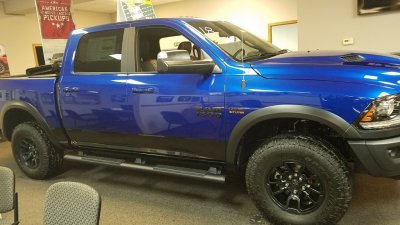

I am a virgin to off road and ram trucks. i am not dumb but cannot for the life of me understand the leveling of a truck? i have looked at b4 and after pics and dont see it? is my eye untrained? i have '18 rebel and wonder do i need this? yes i am a newbie.

need is subjective. If you measure the center of the axle to the bottom of the fender lip on both front and back, you'll see the difference. I believe the difference is about 2-3 inches.

Just to be clear you realize it means it levels the front height to the rear stock height right? Not trying to be a ****, just making sure you’re looking in the right area. Leveling kits you’ll just see a bigger wheel well gap in the front to make it equal to the rear. Your rebel has air suspension so it makes it a lil trickier to level.

From the pictures, you truck doesn't appear to be as 'low' in the front as some others. Maybe it's just the pics?? On some models, such as the LWB Tradesman Series, the front ends being lower seem to be much more pronounced. On those, the 4x4 models appear as low as 2WD models. In fact, my brother mistook mine as a 2WD! The fronts are low enough and with the air dam below the bumper it would negatively affect off road capability if one were bobbing around logging roads, or farm ruts. The lower air dam is at risk of getting snagged on a rut or high rock! During normal use, one could be pushing snow trying to get into their driveway after the snow plows come by and pile it in front of the house.
Normal design conditions would have the axles running straight (parallel to the ground), the majority of the time. I would anticipate accelerated half-shaft wear after lifting a truck due to the axles continually operating at an angle. The greater the angle the quicker the wear. Might not be 'that' great of extra wear if only lifted a small amount, but there's going to be some just because internal axle parts will need to move during EACH axle revolution.
I just left my truck as is, but for purposes of utility, I can see why some might want to raise the fronts.
Yer truck looks nice BTW!

Does your Rebel have air suspension?

On most stock pickup trucks, the visual difference between stock height and leveled should be as clear as day. It usually takes 2" or more of lift in the front to level a 4x4 pickup - typically more like 2.5". On something like a Rebel, it may be a little less obvious.

My buddy has a Rebel with air suspension and it will automatically level
Yeah so I actually just remember that air suspension is standard on Rebel. At least it is for 2017+. So not only would it be useless to level the truck but he wouldn't even be able to without completely taking out the functionality of the air system and then having permanent error codes.
OP- your truck has a very nice and sophisticated system for automatically leveling and you can also manually select different modes. I would just enjoy that system.
