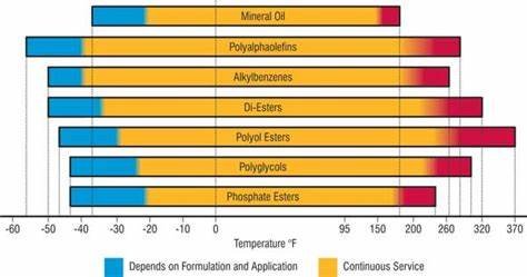

You loose the overdrive pistons first with that valve body I am guessing 68rfe, could be cross leaks. Get a bypass valve and get the heat out of the transmission, it is a conundrum if you live in the snow but regardless those heat valves fail and when they do they take the transmission with it. Use a pao transmision fluid which lowers the safe operating temp, I use redline c+ works great, there are others as well. Look at pour points on stat sheet stay away from the 49F PP's, this is where upgraded fluids pay for themselves, in the extremes hot and cold, see chart redline line 2 and 5, mopar line 1. See safe operating range of temps. There is a ton of threads on this bypass, it is simple to do and will replace that valve pumping heat into your trans. forum search rfe thermal bypass let me know if you have any q's.
