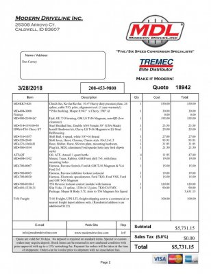

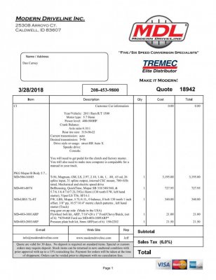

Was at a car show this past weekend and stopped into the Modern Drive Line trailer to see what they thought and ability to swap in a 6 speed into the 4th gen ram, shown in the pics is the a list of parts they came up with and cost..... To my surprise it isn't that bad and less than I was expecting.. Looks like I will be ordering this for a summer project (I hope) instead of rebuilding yet another 545rfe...
Looks like most parts that are need are listed except tuning and clutch pedal set up, which I have covered or can fab up using an HD Ram assembly
Looks like my dream of a manual regular cab ram sport/ race truck is actually going to happen.

The only thing I don't see is a PCM upgrade. Were you going to just ground the trans wiring or try and get TrueStreet to flash the PCM to a manual?

No I will reprogram the PCM to work, Or that is the plan for now. I have talked to a couple of Tuners that feel pretty confident they can get things to work, I even talked to a smog shop about the ramifications of smog and this swap and he sai its all kosher, even with a custom tune as long as the tuning utilizes "stock" or OEM parameters.... the jury is still out on if he knows what he was talking about though...
If PCM tuning fails I will then look into other options on how to make it work... It took some crafty tuning with StarScan when we messed around with my 07 CTD and made it a manual in 09. But we had parameters to work off of with OEM production stuff... that doesn't exist on a 4th gen 1500 though... time will tell and if not I will have an expensive lesson lol

Reflashing the PCM to a manual trans is easy. Simplest route would just be HP tuners, take a stock read, change trans to manual and reflash.
That is what was suggested by some tuners I have talked too. Looks like I'll be selling my Diablo one of these days.
