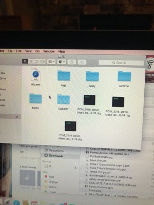

So I purchased a tuner and pcm, got up with jay Greene for a custom tune. Anyone know how to get his tunes onto a I3 on a MAC, me and technology don’t go well
View attachment 125671 What I have accomplished so far, nothing popped up on the tuner

After you drag the file to the tuner, eject the tuner but do not unplug it. Wait until the tuner reappears on the screen and then check to see if it took.
