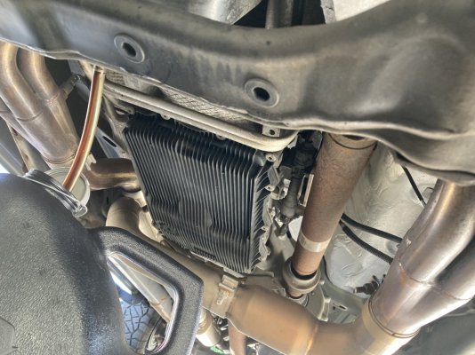

No regrets with the SW headers.
I have MBRP cat back with their “ muffler rated 1/2 way between stock & aggresive” & a y-pipe that goes almost to the muffler.
Sounds great IMO, would sound even better with a cam, which I hope to do someday.
I have no experience with Borla but have read lots of good things about them, I will definitely check them out when it’s time to replace my muffler.
No drone, that I hear with my setup but realize that results may vary depending on individual sensitivey or combinations of the exhaust systems.
