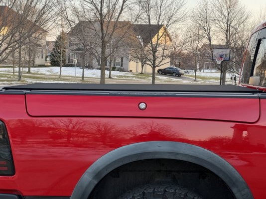

got cover installed. Was not as either would seem. Switching my rails out for the silver ones was a piece of cake. All said and done I am happy and really like the function/look of cover.

Oh hell yes, exactly what I was going to open a post about. You still liking it?
bfill_rebel
bfill_rebel
Mar 25, 2016
810
573
Yes I really enjoy the cover. Appearance function quality all top notch. Couldn’t be happier with my choice.
