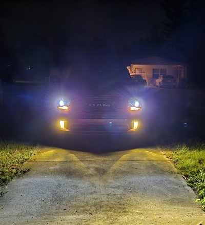

Factory projectors...go with HID. More expensive, but it is the same type of bulb as a halogen(IE: 360 degree light output vs. a 2sided led chip). I have OEM projectors with 8000k HID's and 55watt ballasts that bring the light temp down to about 6500k. I still have a slight bluish tint on the road, but in the rain, they still give good output. If you want less blueish color, you could go with a 6k bulb and 55w ballast, that will bring it close to "pure white".20240819_205925.jpg
