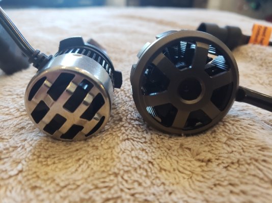

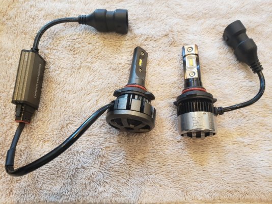

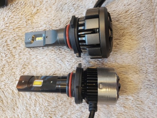

Just curious if you had/have a lux readout on the standard Hikari LED's ($37 for 9600 lumens) vs Hikari Ultra's ($80 for 11000 lumens)?
I recent installed the standard Hikari 9005 in my factory 2018 Projectors (hi & Low same ... with HID enabled and modified/stretched dust covers) which was an improvement over the halogens and about the same as Silverstar zXe's that I ran in the last truck.
Swapped over to the Hikari Ultra's today on the low beam and just curious if you knew. Waiting to see how they do tonight and possible readjust. Here's a bulb size comparison for anyone that might be interested (I'm still in the fence about the modifystreet lights).
The Ultras have a larger fan but shallower depth (still had to use a heat gun on my Mopar projector Dust covers).1d591277ceae235f88694549eebce6cf.jpgce3b7aabda38d500ab646ea0fe4dda5a.jpg9e456f2f6eec35748bc5c3d442301b88.jpg90a0260cabfab48c67159f5ca7e70b43.jpg660aa4bd48175df6db8315dd3925bab4.jpgd7b726a93ad059e5df7d00cf76f449e4.jpg

I don't unfortunately. I sold the ultras before I had a chance to test them and never bought the regular Hikaris.

My Mark 1 Eyeball told me this when testing. The Ultras appeared very slightly brighter in a reflector housing, but not enough to buy the Ultras over the regular ones.
However, the Ultras are noticeably better in projectors when clocked properly. I assume this is due to the narrowed shape of the bulb at the diodes.
In short, Ultras worked better in projectors but if it's a reflector the regulars are nearly the same.

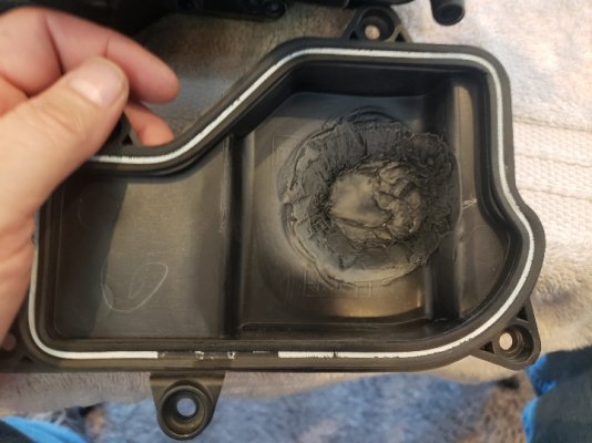

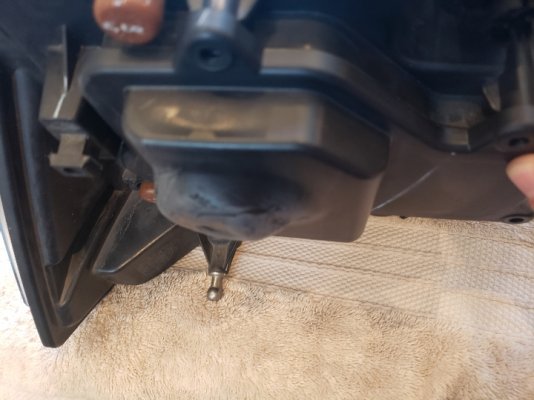

Anyone have issues with melting inside the housings?
