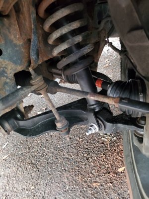

I brought my truck in for warranty work and they suggested a front end rebuild. When I first received my truck a cv axle was broken during the rebuild. After they fixed that, I noticed the sway bar had not been re-tighten, broughtit back. Now fhe truck drives horribly and at 70 it pulls hard left. The lower control arms are two different materials and colors, bugs me. They told me its Mopar only updated one half, think they are lying to me cause their service guys can't do their job?

Do you see any part numbers stamped? My only concern would be that they are both genuine OEM parts. I see a Chrysler logo on the lighter gray one.
Vehicle manufacturers often get parts from multiple manufacturers, or they change manufacturers. Dodge nor Chrysler are in the business of making control arms.
Different colors could be due to different manufacturers.
You say it pulls? Did you or the dealer do an alignment? If not get one.
Also, find a new a dealer, preferably a local shop with a good reputation.

One is 68298346AB and the other 553466439AG. They charged me 89 for the alignment, highly doubtful they did it because I change lanes when the wheel is straight. They set me up an appointment two weeks out and I'm nervous the damage it is going to cause on my tires and rims. I just thought the dealership could do a better job than myself on my driveway with firewater. Lol. I do have a local guy I trust with my daily but I just had it in there for warranty work so I figured let them do it.

According to moparpartsgiant.com
68298346 replaced 55366438
There is no new part supersession for 55366439
EDIT: did you ask for a printout of the alignment results? I always try to ask for one. Sometimes I forget
