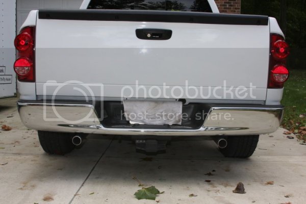

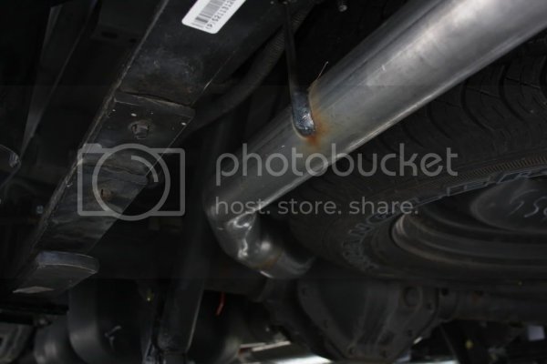

I dont know how yours is routed right now. I took off my spare tire and there is a lot more room now. I found this example on google. My exaust is on the passenger side only and dumped. Here is mine:

After a quick search, I would think it'd be ok, as long as the seller has a good rating and reputation on there. Also make sure what is in the picture is what you're actually getting before buying.

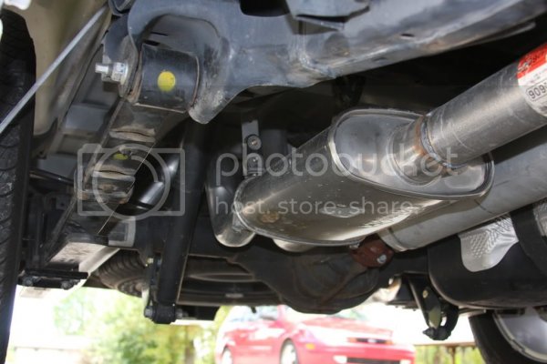

mine is all stock for now i used the mcgaughy 2/4.5 drop it rattled on leaf springs on bumps, i just stood on it to bend it down a little, when i jack the truck up it hits the leaf but you can definatly run your stock exhaust still with little to no modding

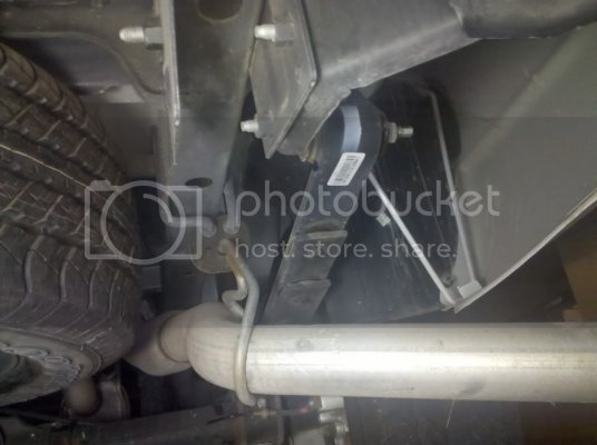

Here's the passenger side(pre-lowered) which I think is going to hit, like jhemi said

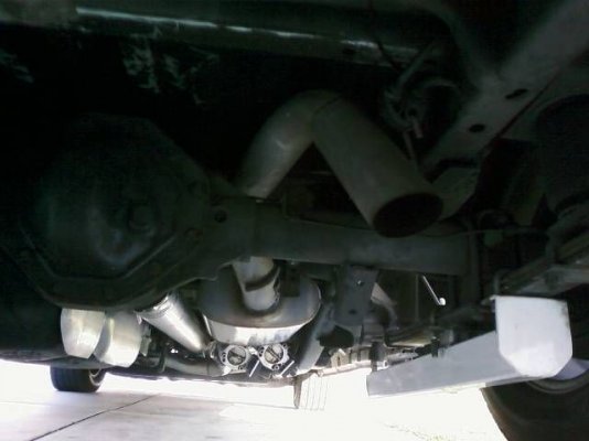

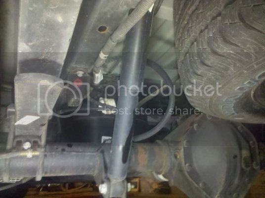

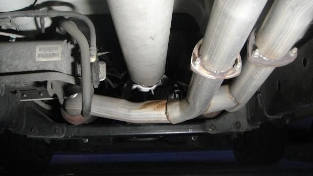

Here is the driver's side that makes having a dual out the back exhaust look difficult. If anyone has a lower Ram with dual out the back I'd like a pic of this side to see how it was routed. Thanks.

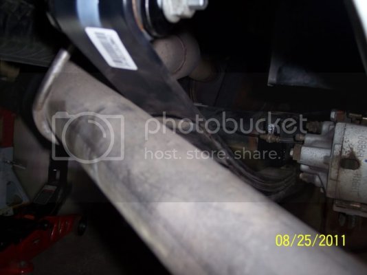

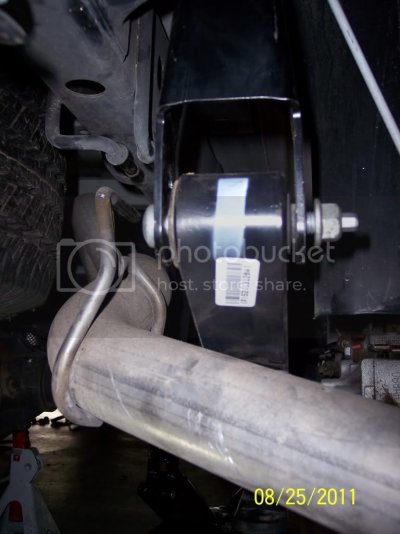

I started installing the drop kit so I'm back to answer my own question.
Answer is: No effing way.
Notice the factory rubber isolator is missing so I could pull it down to allow me to get the spring hooked back up.

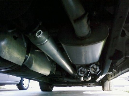

Stopping back into this thread for the update. The truck now has a Dynomax Ultra Flow muffler and dual exhaust out the back. I picked up the muffler from Summit and then had a local shop do the tail pipes. I need to be in the pipe bending business....$200 from the muffler back. But here's the photos.
Drivers side
As for dumping it at the muffler...tried that for about 15 minutes...my age is catching up as it sounded really cool I wouldn't want that for everyday driving around. It was really amplified into the cab coming out under the bed.
