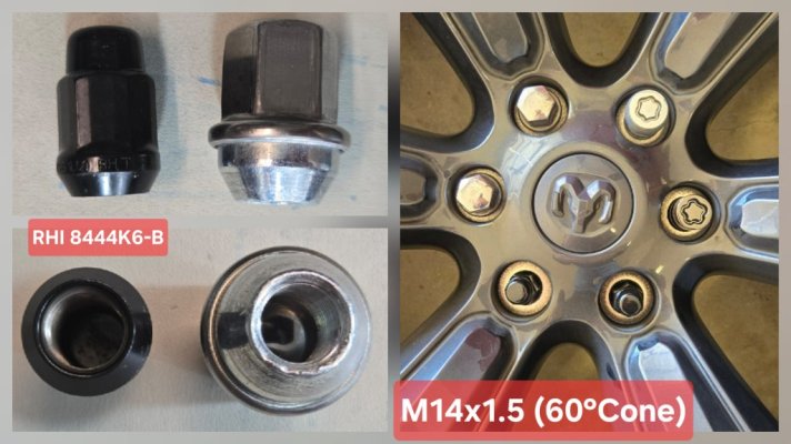

I noticed my factory chrome lugs are starting to swell on my night edition wheels during last oil change/tire rotation and have been looking for a quality black hex style M14x1.5 acorn/bulge nut for awhile now (forum posts/youtube reviews etc.).
Saw some decent reviews of the RHI Black ones (RHI 8444K6-B) and the wife got me a set from Real Truck for my birthday...
>> Can't say I like them and because of how small the cone/seat was on the aluminum rim and I decided not to install them/send them back (didn't seem safe to me. Quality seemed very good though). <<
** I can't seem to find a good part number for Black Gorilla lug nuts and verify they size (22mm socket for chrome ones is promising)
** Anyone have any first hand experience with a quality black lug nut that has a larger bulge/cone seat that holds up well to impact wrench/socket?
(If so how about a link?)

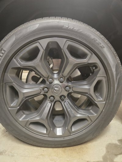

This is what I purchased from my rig in 2020.
They are still in mint condition all these years later.
Gorilla Lug Nuts:66147BDX
14x1.5 Bulge 4-pack
Gorilla Lug Nuts:96641BDX
14x1.5 Locking nut set- Black

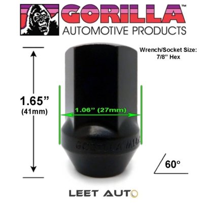

I couldn't find a verified listing for these with pictures/specs/dimensions...
Apparently they were superceded by the 66148FS series (66148FSBC = black coated) as mentioned earlier by @Hemi395 .
Found this listing on eBay for a 20 pack set of 66148FSBC x20 and 7/8" hex size (22.23mm) which has a picture with dimensions to compare to the OEM Mopar lugs... Seems good to go (stumbled on another seller with a set of 24 for $60).
Have the 24pk on order and will report back. If all goes well, will do a roll up thread.
Mopar OEM lug for comparison:
>> Looks like the Gorilla black lug nut locks are still the same (96641BDX), debating on picking these up or not vs using the Black McGard locks (24216) with smaller seat that I'm likely stuck with at this point (past return window). ... McGard doesn't appear to make a large cone seat lock set in M14x1.5 !?
References:
Gorilla CHROME M14 x 1.5 large seat Lugs
PN: 66148FS (Chrome Single lug link)
Gorilla BLACK M14 x 1.5 large seat Lugs
PN: 66148FSBC (Black Single lug link)
Gorilla BLACK M14 x 1.5 Large Seat Locks
PN: 96641BDX (4 pack set)

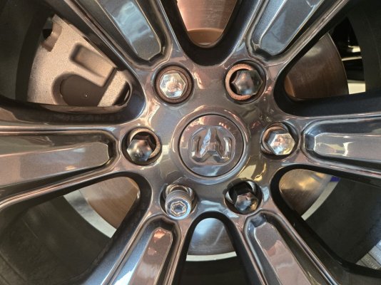

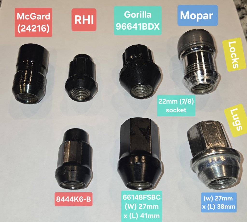

Just an update ...
The Gorilla BLACK M14 x 1.5 large seat Lugs PN: 66148FSBC (Black Single lug link) are a good fit.
I had to abandon the McGard PN: 24216 Black locking nuts as the cone seats are just too small (like the RHI lugs) ... I'm not really sure about the look of the Gorilla Black large seat locks PN: 96641BDX (4 pack set), but will likely have to pick up a set if I can't find a larger set of black McGard.
>> I also need to paint/touch up the seat/cone area of the wheels.... And try to identify the correct color/paint code of these particular wheels some they aren't actually 'Black' but some other shade like Granite Crystal.
Anyone know the paint code?

An update...
Got the black Gorilla locks in and installed.... They seem like the best option out there for our trucks.
They seem to have a shinier finish than the lugs themselves. Either way I'm happy with it...
Found a "Black Noise" Mopar touchup pen that I need to verify/try still.
Color Name: Black Noise
Sales Code: PNW
Mopar Touch-Up Part Number:
68423870AB
