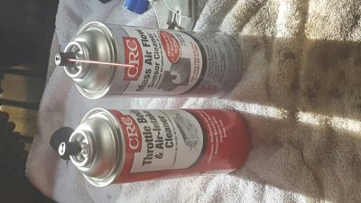

You'll need to buy this PCV (no, not the cheap one the one that's $26) and these two cleaners (they total about $15). And yes spend the $8, buy the mass air flow sensors cleaner. No, dont just use something else, no.

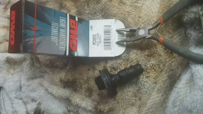

6. Let it all dry while you go back to the truck with the new PCV valve. I had to use pliers to twist off the old one (twisting right, toward the battery, will remove it) and a screw driver to help pry it up. Insert the new one and twist to the left to dock it. (Its the blue piece in the picture of throttle body.)
