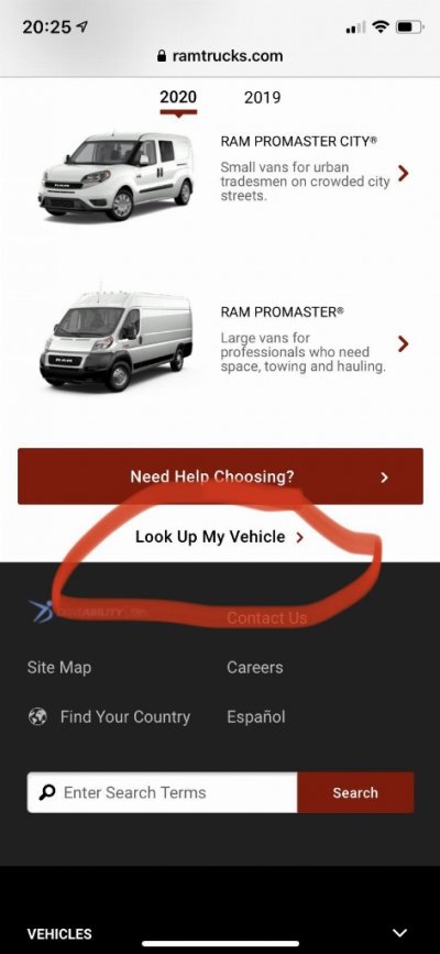

It just took me to the ram truck website. Where do I go from there?
At the bottom of the page. Bellow all the pictures of the trucks and vans.
It says look up my vehicle.
Click that.
Then be sure to use your VIN number.
DO NOT JUST USE THE CONFIGURATION
Has to be your specific VIN
https://www.ramtrucks.com/towing-guide.html
