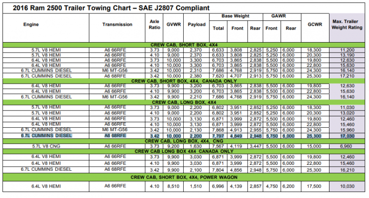

Find what your looking for in a horse trailer first instead of assuming what you need. Depending on the trailer and how it's loaded your tongue weight can be can be 15%-30% with a gooseneck/fiver. You might even notice the trailer axle ratings don't add up to the GVWR of the trailer.
Your big concern isn't the payload but the GAWR for the truck and trailer.

The Trailer I am eyeing has a GVWR of 17313lbs and an empty curb weight of 8282lbs on a gooseneck. The Ram I'm looking at has the ratings in the attached table (I believe my truck's data is in the highlighted row). It appears the rear axle rating is ~3.05k more than the base rear axle weight with a payload capacity of 2.2k and a max trailer weight rating of 17030. Am I looking at the numbers wrong?

The load ratings I have been using are in attached table with the highlighted row being the data for the truck I'm looking at. The numbers seem to work out, but I may be making some false assumptions.

Why go so close to the limit ? I’d seriously consider a 3500 .

OK, U are right at the limit. U really need to consider a 3500 for what U are pulling and loaded. I ran a baby Diesel the ED, and the numbers were one thing, the engine was another. As CRASH said, find your trailer first, then shop from there. But IMHO (very humble), U got a lot of weight, U really need to consider a 3500. But your money and safety, U do wat works for U. Again, all IMHO.....

You definitely need a 3500 with that load.
