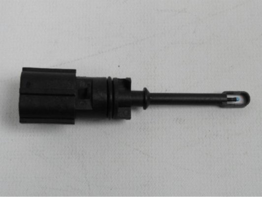

How old is the truck? It’s probably just a bad sensor or one thing you could do, is pull the sensor out of the intake tube and clean it. Over time, it’ll get gunk on the side of the element that faces the flow of the air and cause it to read wrong.

Oh and if it is just dirty, I wouldn’t wipe it with anything, or use anything other than this stuff to clean it. 22418ebc8e251c35899e7703121bf3ff.jpg
