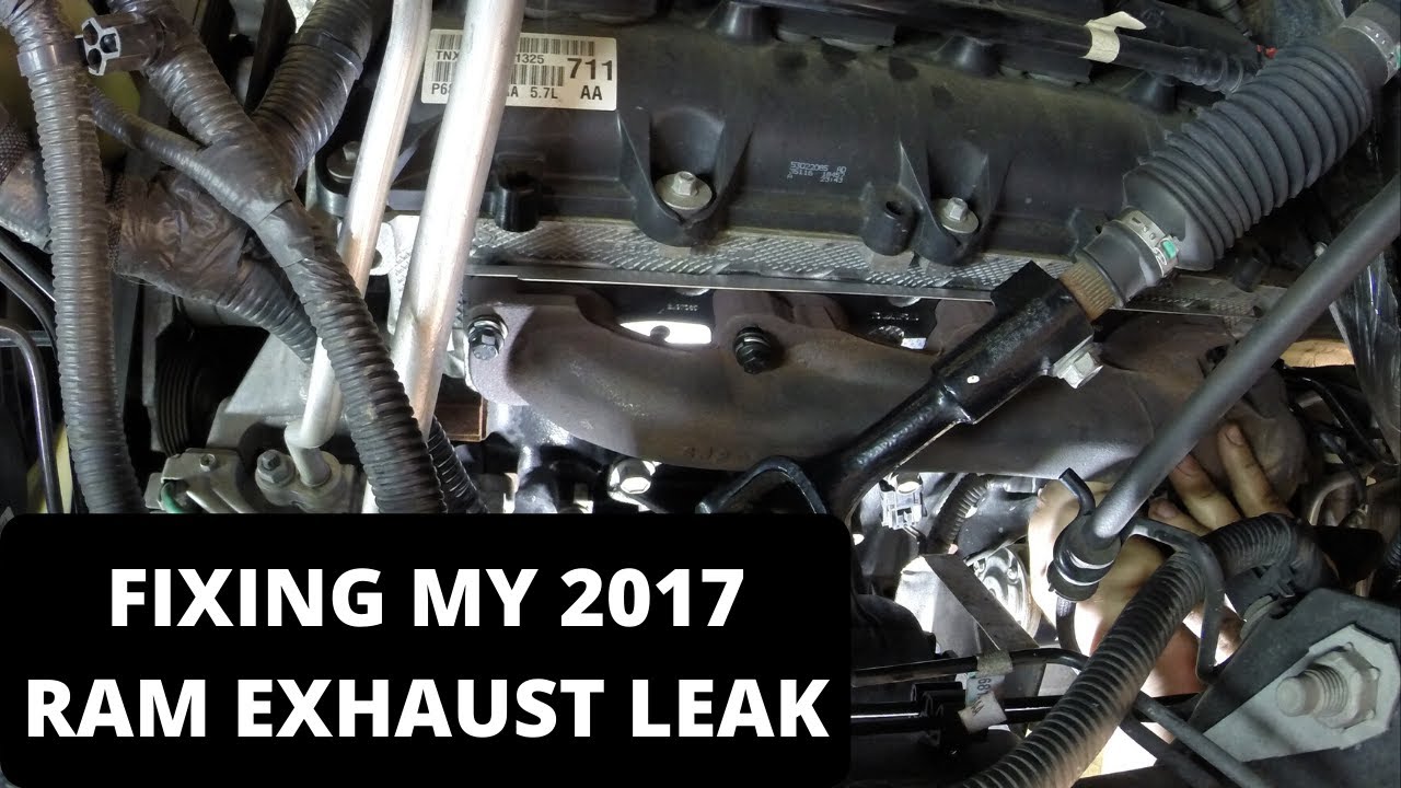

Here is a good video on this. Mine were exactly like the one in the video, the middle were prouder than the ends, by about 1/8". It took about an hour to sand mine flat. I have a knee mill, but I decided the belt sander would be faster than coming up with a fixture for the mill:
I'm not a Ram Technician like @Fast69Mopar, but I have done the job 4 times. Once on a Durango Citadel, once on my previous 2010 Ram 1500 and twice on my current 2013 Ram. The issue always came back.
The most recent was a week ago, and it was the first time I belt sanded the manifolds flat. I was shocked at how badly warped they were, but hopefully this time the issue won't return.
