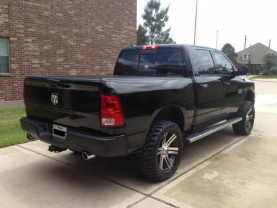

Just installed the Maxtrac 7 inch lift on my 14 ram 2wd. 4.5" lift spindles, 2.5" front coils, 3" rear coils. I have the 1.5" rear coil spacers but I couldn't get them in with what I had but its ok. Did the install myself under the car port and it took me about 10 hours with a few wrenches, sockets and willpower. It wasn't easy but can be done at home. I won't ever do it again but it was a good learning experience. Anyway, got some pics and I'm around the forums pretty often if anyone has any questions. Im very pleased with the results. The pics really don't do it justice.
Lift, wheels, tires:
- 4.5" front spindles
- 2.5" front coil springs
- 3" rear coils
- 20x9 Vortex rims by Mb Weels. +10 offset, 5.3 backspace
- 305/55/20 Mastercraft Courser MXT tires. No rubbing anywhere.
Others:
- BakFlip fibermax tri fold tonneau cover
- Plasti dip bumpers & grille
- Led interior lights
- Led exterior lights (license place, reverse lights, cargo lights)
- K&N drop in air filter

Looks awesome. Off topic - are your bumpers plasti-dipped?

Looks great, getting those wheels in black. ...do they stick out or do you have wheel spacers?

Looks great, can you get total height of truck? (for garage)

So you are at a 7in lift in the front and only the 3in coil in the back?

Looks great! Where did you get the rear coils? Who makes them?
