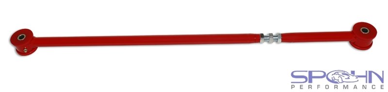

I haven't messed with my panhard bar with my GF drop. If I drop it any further I'll have to mess with it, but I don't think a 2/3 drop is enough to bother it much, or GF would have included it in the kit.
You could always get an adjustable one! Maybe Moes could pick these up :********:ear-Panhard-Bar-2009-2012-Dodge-Ram-1500-4x2-4x4-1.jpg
Adjustable Panhard Bar $135
