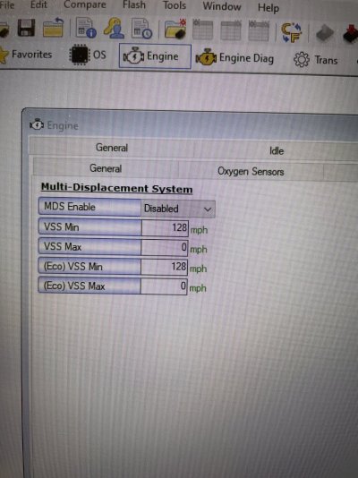

Just so everyone is clear here, MDS disabling in the PCM software is the option I used (sending in the PCM and having a custom tune to disable it)
The other way “most” people get around it is by using the gear +/- buttons to disable it.
If you looked at the shift map tables in the TCM you would see that they are different when the truck is running in normal “drive” mode vs “manual” mode with the gear buttons. All this is fact, look it up on the ZF8 tuning maps for your truck if you prefer to learn from someone else.
Stop being a troll and stifling the growth of the community with incorrect information.

Little tidbit for you, you’re wrong. How could they also change the speed at which this enables if it’s a change to manual mode?
The Edge Pulsar is an inline computer that can intercept and change signals between the PCM and the other vehicle computers. The route I went with was a custom PCM tune (which changes the firmware on the PCM) using HP tuners. That's why I needed to send my PCM in... Below is a snippet of the VCM Editor in HP Tuners where you can see how MDS is turned ON/OFF.
Again, you know nothing. This conversation is laughable.
