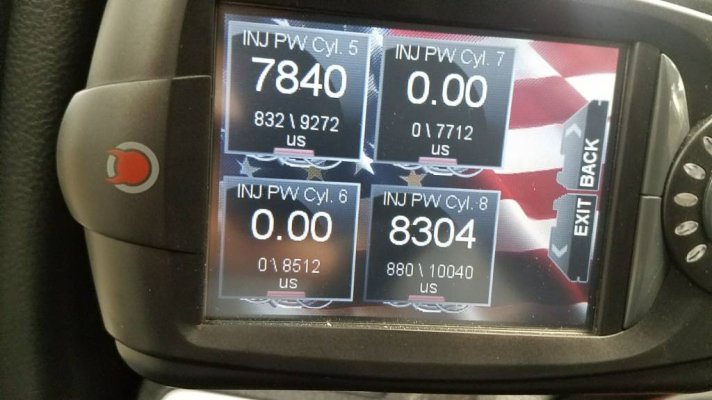

The atmosphere is pushing the air in. Let's ignore manifold pressure readings or any of the science behind any of it and make this as simple as possible:
Photos courtesy of user Hemi395 of data logging with MDS off (top) and MDS on (bottom):
c15a531585198b4e45560faa5e243f02-jpg.400833
Let's look at cylinder 5 and 8. These cylinders are, combined, getting 85% more fuel with MDS activated vs deactivated. If each cylinder is getting the same amount of air with MDS on or off, do you think combustion would be clean with that change in fueling?
So being completely agnostic as to *why* the air flow changes, there are only two possible conclusions here:
1) Air flow does change, keeping the air/fuel ratio the same.
2) Air flow does not change, yet somehow an 85% increase in fuel doesn't cause the truck to run too lean with MDS off and/or too rich with MDS on.
Which makes sense?
