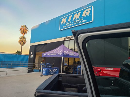

You can't go wrong with King or Fox or any of the big names. In my case I live around 30 min or so so from King, and they have always seemed to pick up the phone fairly quick and answer every silly question i've had and to me that's gold. Same with Radflo, they're literally 10 min away from each other. You can show up unscheduled at Radflo and they'll be more than happy to engage you, show their facilties etc. Icon is about 45-50 min from me, Fox is almost 2 hours away so i haven't have the pleasure to tour their facilities.
I had the chance to pick up my 2nd rear shocks set straight from King
50611191193_3d25bb51dd_b.jpg2020-11-16_05-57-10 by RAM RSM, on Flickr
