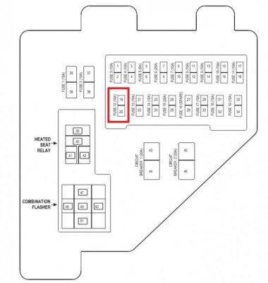

I'm going to guess that the switch has not been tampered with, just the wiring.
Seeing as the old mirrors worked but the new ones dont, try hooking one of the old ones back up (no need to install, just plug it in) and see if it works, you can cut almost all of the troubleshooting out if they work.
If not, and they did work before, its likely you blew a fuse, check the image for the location of the fuse for this circuit.
