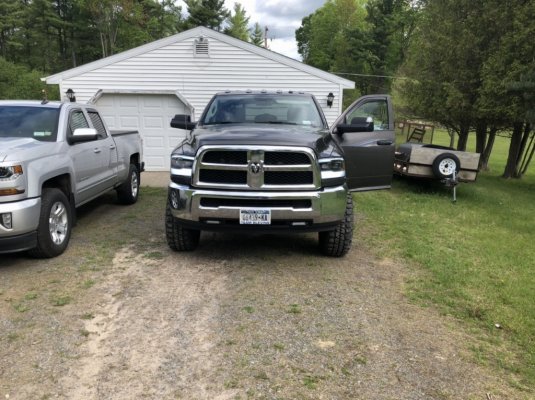

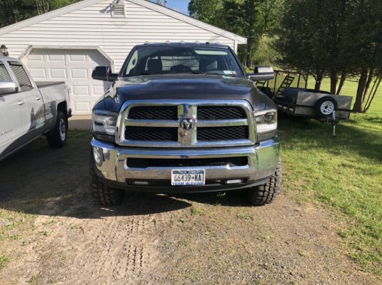

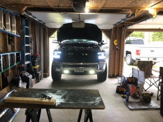

Tested the lights on the truck. 2 minor issues so far, the driver's side Hi-Lense has a very light flicker, only noticed it off the reflection on the bezel. I'll have to double check my settings with alphaobd. Not sure if I have the highs as led's. The other issue is the turns, they function perfect but get the hyper flash on the dash, no lights out, everything is set to led's already because I have switch backs in my quads. I gave the truck a good 20 seconds to adjust. Maybe just needs longer.
Here's with low's (Hikari led's)
Highs
Pick with 4 ways on
Currently have drl's set to fogs so didn't test the drl function. Have everything wired to use the "parking" lights as drl's. All my connections are accessible through the bottom cover so If something isn't right I can change it
2018 2500 6.4L

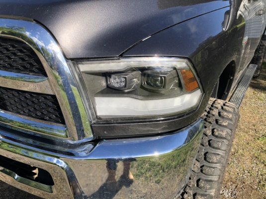

Here is the 98% operational complete build. I had to adjust how I wired the drl's. Originally had them wired as parking lights but when on the upper was white and the lower was orange. So I switched them over to the dedicated drl feed. I ran out of the connectors I was using so they are on their way along with some diodes that Jimmy07 used in his build to stop potential back feed of the parking lights into the drl feed. I may just use the "demon" eyes on the Hi-Lense as my parking lights since that will be the easiest to connect. May run it that way for a bit and see how it works.
Here are a few pics. Will get some night shots hopefully tonight and later will grab some daytime drl shots
