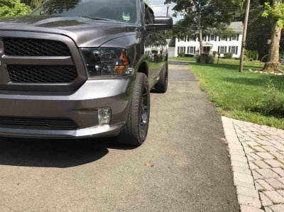

What are some suspension mods to do for sway bars. I'm not big in to lifting this truck. I want to keep stock ride height but slowly build my truck to make it faster and handle better. So if anyone can help me out by first telling me what sway bars are good. Then brakes. Exhaust, tunes, etc. IMG_3092.JPG
