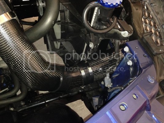

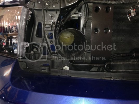

The Vararam is the best performing intake you can buy over the counter, but all the record setting trucks use a home made intake for the track only. It is basically just 4" tubing that runs from the throttle body to a larger air scoop behind the grille with no air filter. Here is what mine looks like on our 2011 Ram...
Thats pretty cool. Thanks for sharing.
I cant see the pics now. But saw them earlier.
No problem. It works great at the track, but does require you to relocate the coolant overflow bottle and is not the most ideal for street use.
