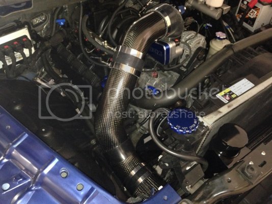

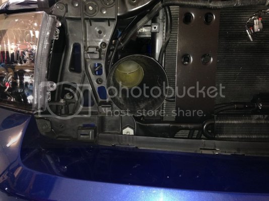

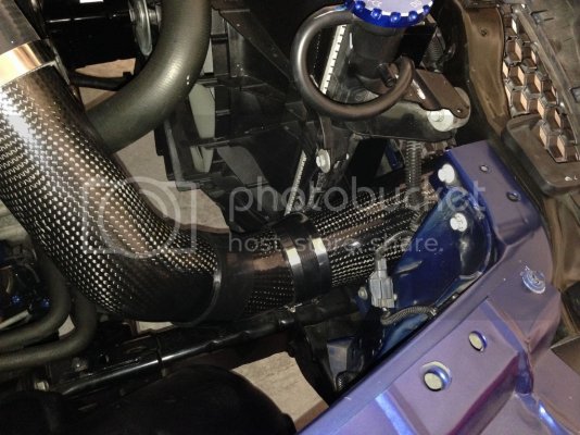

What is the difference between a standard vararam and a track intake?
Pics please
The Vararam is the best performing intake you can buy over the counter, but all the record setting trucks use a home made intake for the track only. It is basically just 4" tubing that runs from the throttle body to a larger air scoop behind the grille with no air filter. Here is what mine looks like on our 2011 Ram...
nickpohlaandp
Jul 15, 2016
741
241
Lake Charles, LA
That's a cool looking TB in the first pic
