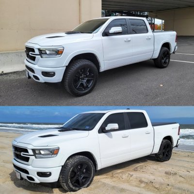

Depending on the offset and lift choice you decide to do. You would be 1" higher than this. These are 35's3A8FBE2A-A546-41F9-9269-149F06D9188B.jpeg

Depends what mopar lift. @Mbrigh3 and @Apiazza are both sitting perfect for 33's. I personally set up both trucks a 2" lift is clean

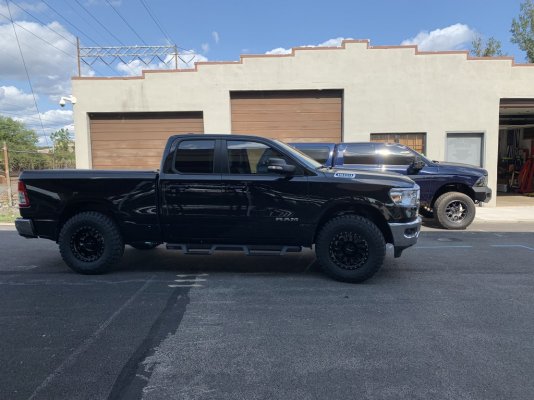

@b8ascrub is the black truck I posted above its a 2" lift (Fox coilovers) on 35's also sitting pretty. It looks menacing in person. Its all how you want your truck to look but if you dont at least level it, it doesnt look much like a truck
I first thought that was more then 2 inches on your truck. Maybe I'll do that as long as dealer doesn't gouge me. What would be a fair price for the lift? And, are there better versions of a Mopar lift then others? If so, then I will be specific with the dealer. I assume they must redo the alignment as well.

My truck has a 6” lift because it’s the blue truck behind the black truck LOL. I don’t know anything about mopar lifts and what dealers can and can’t do unfortunately. They seem to make their own rules as they go along
