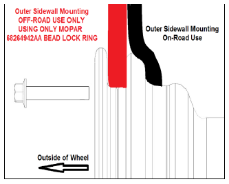

These are actually really well designed wheels. They have a dual mount design for on or off road due to legal restrictions for beadlock wheels.
Heres a pic from the installation paperwork from MOPAR
