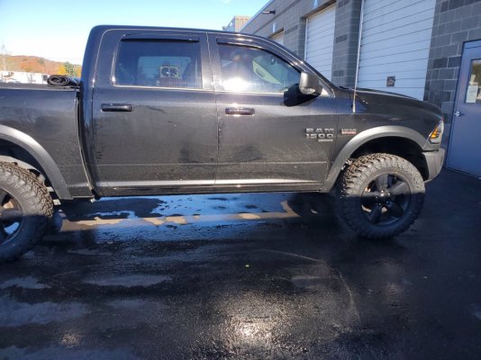

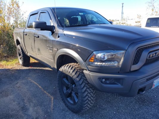

Here is my 19 classic warlock with a 2 inch front kit 1 inch rear spacer and 1.5 inch body lift,
On 35 12.5 20's,
This is my second 4th gen ram I've done this to and very happy if you are on a budget, I also upgraded UCAs for peace of mind the stock ones worried me because there was separation in the ball joint even before I did a lift.

View attachment 479049View attachment 479050
Nice setup!
