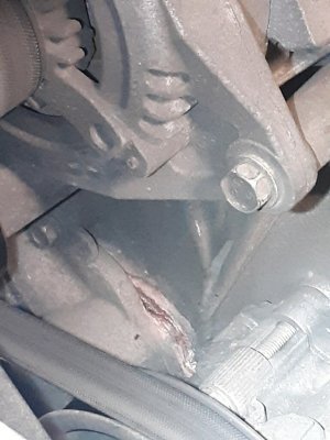

I was throwing in my AEM drop in filter when I noticed a nice dosage of coolant leaking (pics attached). Dealer had just done work on this no more than 6 months ago. Replaced thermostat, radiator cap, gasket, full coolant and transmission service as well. Frustrating to say the least.
Weird because I didn’t smell any coolant and truck seemed to be running fine. Checked coolant level and that’s a bubble under max as well. Any ideas where it’s coming from before I take her in again? (Sigh)

IS it possible all that from when work was done and the area was not cleaned properly? Grabbing at straws...
If fresh, maybe gasket leaking and all over from throwback from fan, again grabbing straws...

It’s definitely possible. Would of thought I noticed this though...might try and clean it up myself and see if there’s a fresh leak from somewhere...

Looks like the thermostat gasket **** the bed.

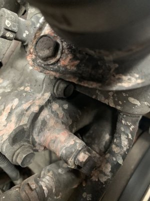

Gasket, you need to replace gasket everytime you replace it, dealers are notorious for not doing so. You could probably just use some gasket maker done. If you have oat and not hoat, then you should fix that asap. You may have hoat, but another larger issue is did the dealer put back oat into your hoat, at that point I'm flushing.
When you get the thermo stat off, put your finger around and see how slimey that is. I guess misery loves company, I will be doing a thermo stat for a friend this week.
Drain some off, it should be nice clear orange.

Thermo stat gasket was not tight enuff, they caught it, tightened it,then failed to clean teh engine
or, the hose was not down far enuff on the nipple, I would check that first. amke sure the hose clamphas a good bite, all around the termostat housing nipple/
then wash the engine, when hot. clean thoroughly. wash for any other leak indicators.

I just did a thermostat and water pump. The hose connection to the thermostat nipple is not great. The factory hose leaves some to be desired thickness wise. It looks like it may be running from bottom of hose where it ends down the nipple. I had to adjust the hose and spring clamp, and then added a second worm clamp. I will be replacing the hose soon. There were bad batches of hoses also from the factory that were sometimes affected by the coolant. Another reason I’ll be updating hoses. I just hope I can catch a lot of my coolant. Very expensive to lose after I just replaced it all.

Possible there could be double gaskets. Most thermostats come with gaskets themselves and throwing a second one on there could sure cause a leak.

Well it’s definitely a fresh leak. Cleaned the whole area up yesterday and started it up. Nice dose of bright orange coolant coming from that thermostat gasket. Loose bolt and ****** gasket. We’ll see what else there is. Dropped her off at the dealer an hour ago.

Dealer called. Main culprits are the water pump and upper radiator hose. Both need replacing. Also stated the fan clutch was “squeaking”, found a lose bolt in it and crack as well...also needs replacing. They’ll have it through the weekend sounds like and I’ll be out of the country on vacation. Time to drink away the pain!
