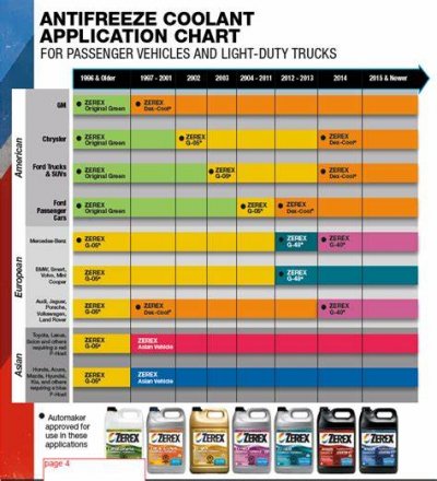

4 basic coolants, iat old stuff, hoat newer then iat stuff stuff, and oat newest stuff or longest lasting, and asian which is hoat but absent some items for specific reasons, Bottom line, they don't mix. 6 mos ago my friend dumped dex into his nissan, I told him wrong stuff he said whatever, it started over heating about 4 mos later, last week we flushed drained and new thermo and put back zerex asian, everything is a ok. Yeah there are some other coolants, but this is what manu's use by year.
btw, I wouldn't put dex into a fca product, so I'm not saying you should use this chart, just use it to identify year, research the correct coolant. fca purple is a dex clone, but it aint dex.

Zerex g0-5 is probably the best coolant made, not the longest lasting so you should flush every 40k miles, but the least likely to gum **** up or corrode. Dex can gum up and iat can corrode because you have to change it so often, and if you forget, it goes bad quick.. It is a HOAT, so either that or Mopar HOAT, and I'm very glad my truck takes this. Our systems are hard to flush, engine bolts are very hard to get to, especially drivers side, so unless you are a glutton for punishment, it is best just to do a series of dilute type flushes. I get mine full strength and mix it with distilled water 50/50 before putting it in truck. I am always at 50/50 mix no matter how much I get out.

Zerex go5 or mopar hoat is all you need to know, either way it is very cheap and very necessary. Drain some of the radiator peacock and check the color. It should be a nice clear orange/red. Now, the one thing is if you use go5 it will change the color, so you need to get used to that gold, but it's cheaper then mopar hoat. same stuff, just a different color.
If you get Mopar, make darn sure it says 5 year and not 10 year.
