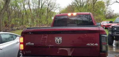

So to update my tails continue to have the passenger tail light only stop working , blinks intermittenly then goes out only allowing the brake and turn signal to work.... I've swapped taillights to opposite sides to have the same symptom occur on the pass side only ...... I've disconnected any aftermarket lighting ( tail gate light bar , third brake light , hitch receiver light etc) only to have same result.
Returning these lights seems to be one of my only options as I ordered these through [email protected] who got them thru TRS....neither of which can seem to give me any help for this issue .

Well started the truck this morning and now the passenger tail light isnt working at all...
