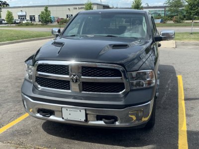

Hmmm... lots of "mods" that we did while rebuilding my truck we bought from an insurance write-off... was a 2015 CC 6'4" Tradesman edition. I got to cheat and almost everything came from auto wreckers at employee pricing... so we went for the moon.
Mod List: (Completed)
Front bumper with fog lights and tow hooks (2 mods ?)
Sport Hood with under-hood light (2 mods ?)
7" Prem Cluster (1)
8.4 Touchscreen with Nav (1)
Dualzone HVAC Bezel, with Auto Temp (2 mods? but still need to do the heater box)
10/6 Heat/Vent driver and pass seats in black Laramie leather with memory (1)
Full Center console with new main bezel (1 mod)
Black Leather rear 60/40 seats with armrest (1)
Aftermarket seat heating kit for the back seats (1)
Overhead Console with homelink and rear slider window switch (1)
Rear Sliding Window (1)
Weather-Tech floor mats (1?)
Added extra dome light (headline had hole in middle, so added one with on/off at the back) (1)
Switched dome lights to LED bulbs(1)
Switched overhead console lights to LED bulbs(1)
Switched CHMSL brake/cargo lights to LED bulb) (1)
Switched license plate lamps to LED bulbs (1)
Added Upper Glove box with light and door that says "Laramie" like the seats do. (1)
Sun-visors with mirrors and lights, both sides (1)
Rear View Mirror with auto dim and microphones (1)
Heated leather steering wheel (1)
Door panels front/back with leather and lighting (1)
CD player in console (1)
Dual USB in front and back of center console (2 cause I bought 2 ?)
Side Mirrors in chrome with power fold, puddle lights, signals and memory (1)
Side steps - 5" oval (1)
Backflip G2 hard Tonneau cover (1)
Switched to dual exhaust (1)
Rear bumper with dual exhaust cut-outs and parking sensors (2)
Backup Camera (1)
Shorty 13" antenna (1)
3 x "Support Our Troops" decals. (1 if we are counting decals?) (1)
Center Dash Lamp Sensor switch to a 4 pin one with sun sensors (1)
Humidity Sensor (1)
Remote Start (1)
EGR in-channel Window Visors (1)
Mods still left to do (have the parts, just need the time to wire them in)
Full Alpine Amp and all 10 speakers (have the door/headliner harnesses to make it easier) (1)
Adjustable pedals (1)
Chrome interior door handles. (1)
Putco Chrome Mirror covers (to coverup damage on one mirror cover) (1)
Husky Mud Guards (1)
So... 41 (depending on how you count them) with 5 still to do. I think that's everything... wow I never wrote it all down before.
We call her "Frankie" because we brought her back from the dead and rebuilt her with parts from ~11 trucks. I want to get some sort of Chrome/Black nameplate made "Frankenstein Edition"

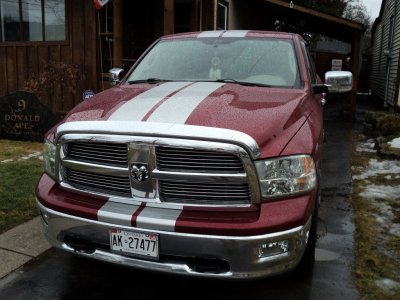

She started out as a base model tradesman looking like PIC1 and now looks like PIC 2
