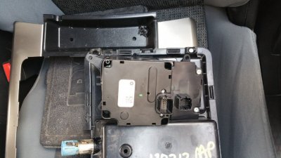

Well, fail for me. The piece behind the knob was much larger than I thought (should've checked that 1st, I know). I was thinking it would just be a plug plugged in to the knob... not so much. Unfortunately I can't see how to make it work without modifying my actual shift mechanism - tearing off the screw tabs - and I don't have the manhood to tear my truck apart without knowing it would work. The wires going to the shifter (and 4WD) would also need to be extended I think, but not by much. From the factory, this should absolutely be doable, I just don't have the know-how after market.
The other option could still be some sort of plate which covers the large hole in the current console insert.

It looks like from your three photos KahneFan that the wiring harness for the shifter knob is indeed separate from the transfer case selector. Do those pins correspond to the console grip shifter harness you have? If not, has anyone seen the WK2 console grip shifter to compare the harness?
Next up, if the Ram rotary knob and the WK2 shifter are common harnesses, then I would make an extension for that harness and make a pretty bezel to place the shifter from the Jeep into.
I REALLY want this to be a thing. I don't hate the knob but I have been patiently waiting for someone to hack this setup.

What about getting a '13 center console bezel for the console shifter, then dremeling out the PND12 notches to make room for the rotary knob assy.? Then extend the harness and drop it back in to the center console?
Just spitting ideas.. hard to tell if it would work without holding the pieces.
I'm not a huge fan of the dryer knob, but it also (clearly) wasn't a deal breaker.
That's what I was looking to do but, as you can see in Post #22, the shifter assembly was larger than I was expecting. And, I would have to cut off the top mount bracket of the shifter, and I didn't want to "damage" my OEM part - since I would guess that's not a cheap replacement part.
