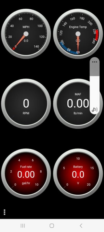

You want to check consumption use your OBD reader. My mx+ displays consumption figures at idle or when driving. I is suprising how much fuel a 6.4 burns at idle.
Screen shot of my obd read out. Connected and engine running it populates these gauges. Lower left is gal/hr consumption.
I'll have to take your word for it. I don't have an OBD reader.
