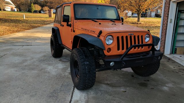

I went from GY MTR/K's to the Cooper ST/Maxx's on my Wrangler. Both 35x12.5r15's though. The Coopers are quiet. Very quiet, compared to the MTR/K's anyways. I've had no problem with them in any terrain.
I think they run a tad narrow.
