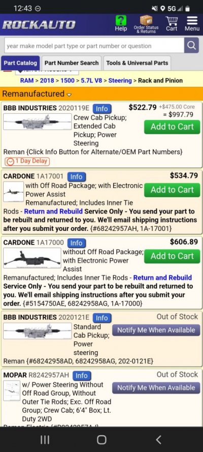

The rack replacement is relatively easy. Just had mine done. But you'll need a scan tool to reset some stuff. You can pick up a reman'd rack off rockauto for less than $600, there's a core charge, but you'll get that back after you send the old one back. It cost me less than $900 for rack replacement and alignment. I bought the rack, had a local shop I trust do the work. Took longer to do the alignment. Dealers are backordered on the racks, last I checked, 45+ days. Rockauto may or may not have one in stock, but check back daily/every few hours, since the inventory is adjusted as they get them in. Fyi, oem part is only warranted for a year 12k miles, cardone rebuilt is 5 years.

There must be some changes to the EPS unit between 2013 and current Ram 1500 classics.
Rockauto doesn't have any replacements in stock for a 2015. They only offer a you a service, where send your inop unit to them, then cardone rebuilds it and ships it back to you.
But if you search a 2018 Ram 1500, aftermarket EPS units are available for $800.
Either which way, nothing is cheap these days when your vehicle needs fixing. $2-3K isn't out of the ordinary for a somewhat routine repair.
There's no difference. They are the same from 2013-current. The one in my 2019 that I just replaced came out of a 2013 based on the vin that was coded to it. In fact, i had to drop to a 2018 to even get a part number since they don't list the rack for 2019 yet. I've searched for 2013 and it's the same part number from cardone. Their inventory changes as they don't have a ton in stock. The rebuild service is a great way to at least get yours sent out and repaired instead of waiting days or weeks for one to come in.

Fwiw, it pays to research compatible oem part numbers. Not sure why the following rack isn't listed for earlier models, but is for a 2018. But if you compare and cross reference part numbers, it should fit.

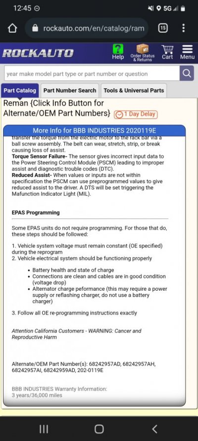

I'd love to see inside one of these EPS units to get a feel for how the circuit board is mounted and laid out. Plus how the motor in it works. There's nothing on the u-toob in terms of the internals on them at this point. Given they've been out there for ~10yrs now, we're probably going to see more issues crop up.
Like said though, for the most part, EPS issues have been far and few between.
As @hunterdan said, the lowest cost way to go about replacing them is buy one aftermarket and have a shop you like do the swap for you because advanced scan tools and a subscription service are going to be needed to make it work with your truck after the swap.
